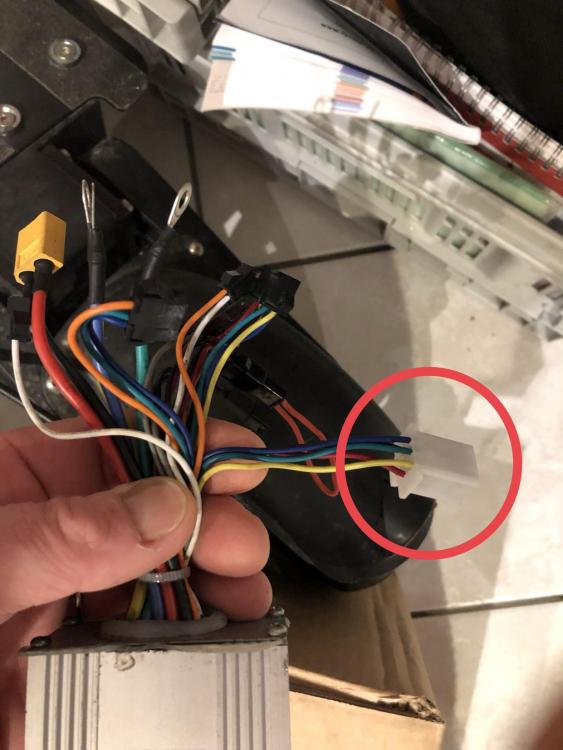

GXM Posté(e) le 7 décembre 2018 Partager Posté(e) le 7 décembre 2018 Hello guys. First of all i am sorry for writing here in english language i am from Czech rep. and i am hopeless with my scooter. I cant find any other disc. forum in whole world. Hope you will understand me. I bought UBGO simillar scooter - Chuanglu (Ultron) V9 scooter and my seller quit the business on alliexpress. My controller broke up, and now i cant find any compatible on the web. I contacted manufacturer of controller, search across all internet malls, try to contact people in Ultron groups - but nobody answered. So i tried to contact KWK and they dont want me sell controller without motor. Daibot even do not want to sell any parts without buying original scooter first - same at Fineone store. So i trying ask for help here. I searching for 48V 25A 1000W brushless motor controller with size (same as ubgo) that fit in my scooter. I do not want to buy new motor+new controller+new speed meter KIT - its very expensive with the shipping included. Can anyone help me ? Can anyone have any advice ? Anybody knows where to find this kind of controller or other compatible? I will be very happy for any help and advice ! THX  Citer Lien vers le commentaire https://www.espritroue.fr/topic/7277-ubgoultron-v9-controller-advice/ Partager sur d’autres sites More sharing options...
Erwanrcx Posté(e) le 7 décembre 2018 Partager Posté(e) le 7 décembre 2018 (modifié) Hi @GXM can you share more information from your scooter ? Maybe you can send some pictures from • motor ? Is it dual motor scooter ? • lcd maybe there is different technology on your scooter than the models sold by KWK. Lcd software or motor’s poles... What is the maximum voltage of your Battery ? 52V when battery full charge ? In fact, there is many settings which can be different on different scooter brand. Last UBGO i did service, it was a connector from motor ( red circle on the picture) for hall effect i think... this is why, i think KWK ask you to order new lcd, new controller and new motor Modifié le 7 décembre 2018 par Erwanrcx Citer Lien vers le commentaire https://www.espritroue.fr/topic/7277-ubgoultron-v9-controller-advice/#findComment-157285 Partager sur d’autres sites More sharing options...

GXM Posté(e) le 8 décembre 2018 Auteur Partager Posté(e) le 8 décembre 2018 14 hours ago, Erwanrcx said: Hi @GXM can you share more information from your scooter ? Maybe you can send some pictures from • motor ? Is it dual motor scooter ? • lcd maybe there is different technology on your scooter than the models sold by KWK. Lcd software or motor’s poles... What is the maximum voltage of your Battery ? 52V when battery full charge ? In fact, there is many settings which can be different on different scooter brand. Last UBGO i did service, it was a connector from motor ( red circle on the picture) for hall effect i think... this is why, i think KWK ask you to order new lcd, new controller and new motor Oh, I found the difference - that wire in green circle is for ? I do not have this cable on my controller. Citer Lien vers le commentaire https://www.espritroue.fr/topic/7277-ubgoultron-v9-controller-advice/#findComment-157351 Partager sur d’autres sites More sharing options...

Erwanrcx Posté(e) le 8 décembre 2018 Partager Posté(e) le 8 décembre 2018 Il y a 2 heures, GXM a dit :  Hi this green circle is used to connect front controler when using dual motor. Then you have same connector than the red circle ? In this case i can try to speak to Daisy at KWK smart life shop. Citer Lien vers le commentaire https://www.espritroue.fr/topic/7277-ubgoultron-v9-controller-advice/#findComment-157373 Partager sur d’autres sites More sharing options...
GXM Posté(e) le 8 décembre 2018 Auteur Partager Posté(e) le 8 décembre 2018 (modifié) 2 hours ago, Erwanrcx said: Hi this green circle is used to connect front controler when using dual motor. Then you have same connector than the red circle ? In this case i can try to speak to Daisy at KWK smart life shop. Yes i do. Its same, but on KWK they selling only THIS 52V version ... or not ? Is 52V compatible with 48V motor ? If you can try to speak witch Daisy, i will be very gratefull  Modifié le 8 décembre 2018 par GXM Citer Lien vers le commentaire https://www.espritroue.fr/topic/7277-ubgoultron-v9-controller-advice/#findComment-157393 Partager sur d’autres sites More sharing options...

Erwanrcx Posté(e) le 8 décembre 2018 Partager Posté(e) le 8 décembre 2018 Your battery is already 54,6V, not 48V. It’s 13S serial battery, ... new UBGO are 14S battery —> 58,8V that’s maybe the problem about Daisy speaking ...  And by this way i can’t have spares. In other way, maybe there is another solution. I will speak to KWK about it. I sent you PM Citer Lien vers le commentaire https://www.espritroue.fr/topic/7277-ubgoultron-v9-controller-advice/#findComment-157429 Partager sur d’autres sites More sharing options...
GXM Posté(e) le 8 décembre 2018 Auteur Partager Posté(e) le 8 décembre 2018 5 minutes ago, Erwanrcx said: Your battery is already 54,6V, not 48V. It’s 13S serial battery, ... new UBGO are 14S battery —> 58,8V that’s maybe the problem about Daisy speaking ...  And by this way i can’t have spares. In other way, maybe there is another solution. I will speak to KWK about it. I sent you PM Oh, i though that battery output is 48V and charging voltage is 54,6V ... new UBGOs have 52V output, so 58,8V is charging voltage ... ? Maybe ? ... I do not know. If i need to change motor also, i should buy new scooter . Citer Lien vers le commentaire https://www.espritroue.fr/topic/7277-ubgoultron-v9-controller-advice/#findComment-157432 Partager sur d’autres sites More sharing options...
Erwanrcx Posté(e) le 8 décembre 2018 Partager Posté(e) le 8 décembre 2018 I’m not sure if over-voltage is a big problem for the motor... Maybe it can be much nervous and powerful. But, the problem comes from battery and security for discharge. 52V controler will cut power before, then you will lost autonomy. Citer Lien vers le commentaire https://www.espritroue.fr/topic/7277-ubgoultron-v9-controller-advice/#findComment-157433 Partager sur d’autres sites More sharing options...
