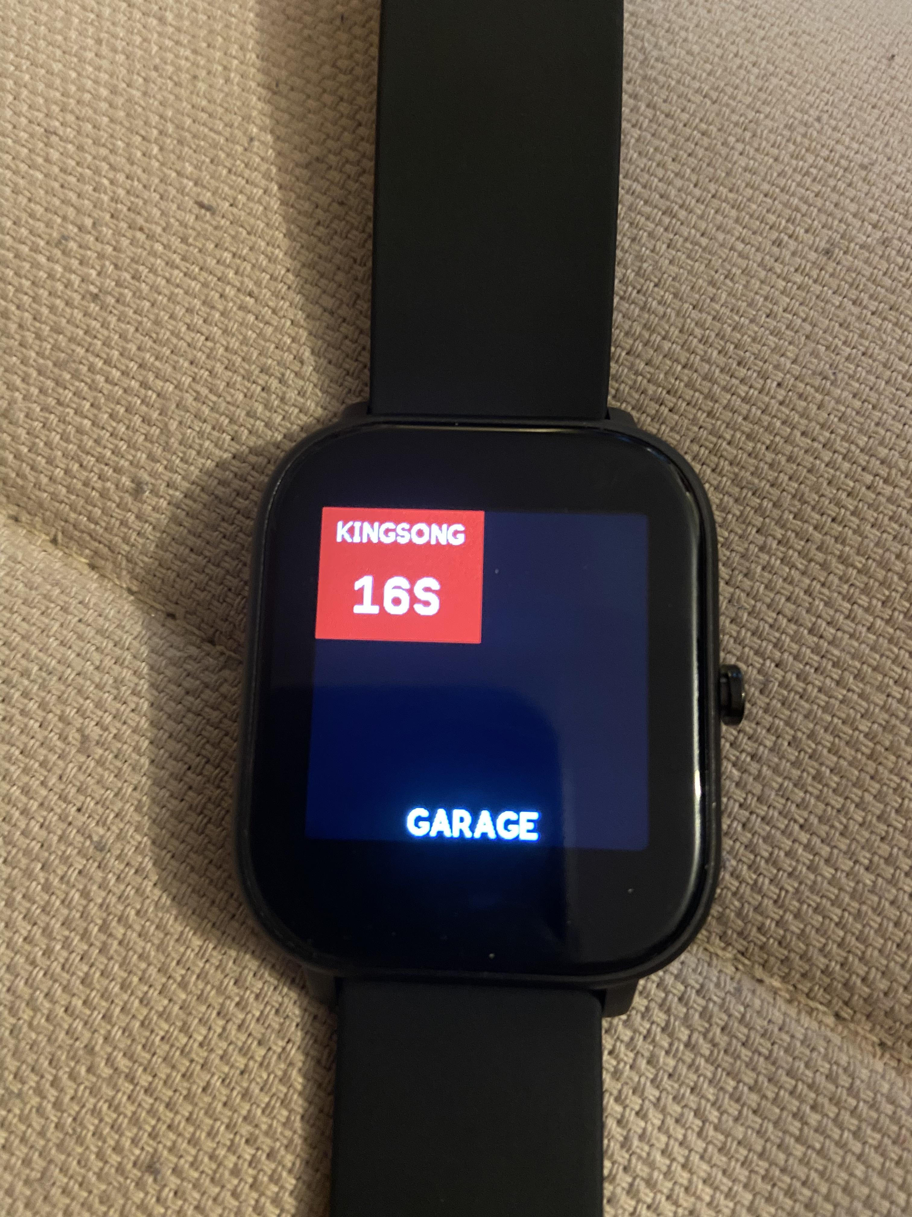

@nec if you go to the garage page, is the model of the wheel displayed correctly?
Does it say KS16S ?
il y a 7 minutes, enaon a dit :
Does it say KS16S ?
Yes @enaon
kingsong 16s
Modifié par nec
33 minutes ago, nec said:
Yes @enaon
kingsong 16s
Thanks, I have now pushed the change.
Go to the loader page from the phone or PC, and it will say one update is available. Do the update and please report when you have some time  if the battery level is now ok.

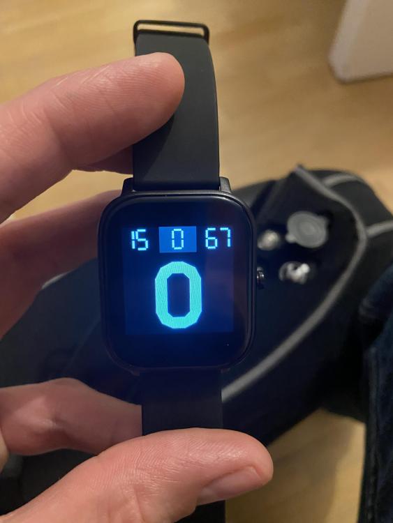

Nice. When you connect/disconnect the wheel, you will see that for a second or so, three little icons are displayed on top. The are supposed to help understand what the readings are, I will make it a bit better, but to explain:
left is temp, right is battery, middle is amperage. They are all collor coded, will change depending on state, you can set the limits on the haptic menu, it not just for the haptic, it is for the color coding of the dash too. So set the limits, and if you don't want the haptic, just disable it, the color coding will work.
the speed color coding follows the speed alarms, even if they are disabled. The speed dash will get white after speed alarm1, yellow after 2 and red after alarm three.
Also the amperage alarms  will make the speed dash change collor if they have to. If you are going slow, but way over the amperage limmits you have set, say you are going uphill, both the amperage and speed will change color,
The idea is that if there is something that you need to pay attention to, it will be in bright collor.
Modifié par enaon
Ok
i ll test tomorrow (haptic alert for the speed and battery for the moment)
But in the middle i always show 0 as u can see in pics
Modifié par nec
yes, it is 0 because you are not moving . If you put it to the charger, it will say 2, and get white. White on amperage is negative, it indicates braking or charging :)

the haptic feedback is progressive, I will expain a bit how it works.
For the case of amperage, and braking:
Example:  set the breaking amperage to 7 amps, with a step off 1 amp.
When breaking, if the amperage generated is 7 amps, one short pulse will come to the hand in the form of haptic feedback.
If 10 amps are generated, 3 pulses will come.
if 13 amps are generated, one long pulse(5 short ones are made to a long one) and 2 short will come.
This way, you get info without looking at the watch.
Modifié par enaon
