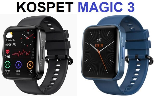

there is now a new candidate if one is brave and wants to be future ready. This looks like the next watch eucWatch will run to, by the end of this summer I guess.:
https://www.chinesesmartwatches.com/kospet-magic-3-smartwatch/
