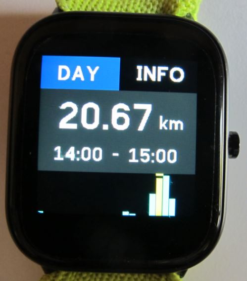

J'ai testé ce nouveau logiciel cet après-midi, une seule chose à dire : parfait.

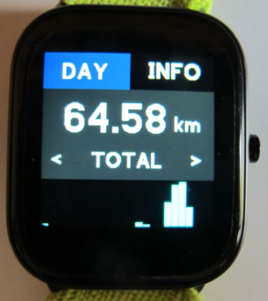

Maintenant, il y a quelques statistiques :
le graphe en bas donne heure par heure la distance effectuée
On peut déplacer un curseur jaune pour détailler, par exemple entre 14 et 15h j'ai fait 20,67 km.

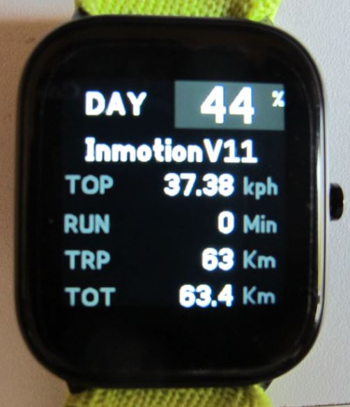

En pressant INFO on a :
Je pense que 44% est le restant de batterie v11.
Please, @enaon, just a detail, can you tell me the difference between these 4 values
-- screen 1 : 65 Km
-- screen 2 : 64.58 km
-- screen 4 : TRP 63 Km  and TOT 63.4 Km
- screen 1: 65 Km
- screen 2: 64.58 km
- screen 4: TRP 63 Km and TOT 63.4 Km
It is somewhat the same number, just a round up to closer value because some fields have room for decimals and some do not. I will fine tune it a bit more.

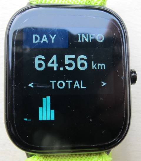

you can also press on "day" (which is not really day, it is the last 24 hours, this is why it is a bit more, you had a little usage yesterday) and it will display week and year.
Quote
You can move a yellow cursor to detail, for example between 2 and 3 pm I did 20.67 km.
you can go to setting from the clock face, press the "i" button on the bottom center, and then press the 24h switch to make it 12h. This will also change the logs format, so it will read "2 and 3 pm":)
