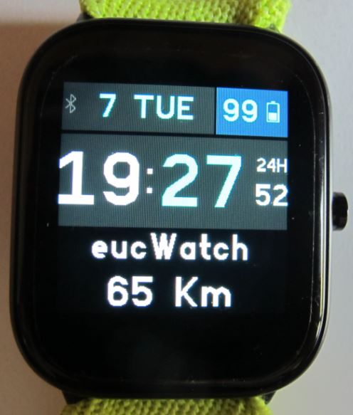

one more info, this number on the clock face, is the total distance af all garage slots on the watch added (each slot has it's own logs), so the name could be Techos78 instead of eucWatch. :)
you can change it if you like from the loader, there is a "change settings" button there. You can also add your total distance up to now if you know it, and it will add it too.
Remember to press the disconnect button when finished on the site, it will automatically restart the watch for you. The testing loader is improved, it takes the watch to devmode automatically to make sure no comms are lost due to memory, and restarts the watch when disconnect is pressed.

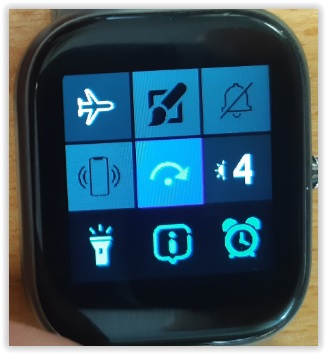

maybe you turned off the loader support on the settings?  It is the >. icon on bluetooth menu, is should be blue for the loader to work. A restart is also needed after you make it blue.
Do you mean this icon in the middle of the second line ?
It does not look blue on the picture because the camera used the flash, but actually it is.

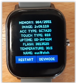

And Restart using this menu ?
When I press it, screen turn black for less than 0,5 sec, the watch vibrates twice and tdisplay turns immediately  to date and time. I wonder if the Reset is effective because it happens so fast.
2 hours ago, Cormo said:
press the airplane icon (this is the Bluetooth icon when all services are off). Inside there will be a >. icon (this is the ide/loader icon), make it blue, and then press the "restart"(this will also save your settings) button on your second picture, From there on the loader will work.
yes, restart is that fast, we are on a microprocessor. :)
ps. the icon in the midlle(the arrow and the dot) is the turn-to-wake-screen accelerator function. It consumes some battery, so you can have it off to maximize standby battery life. It will automatically turn on when you connect to the EUC, and will revert to the state of this switch when the connection to the EUC is closed, so you do not have to enable/disable it manually.

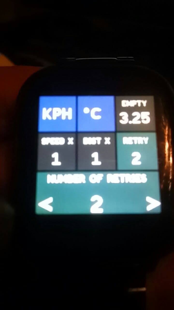

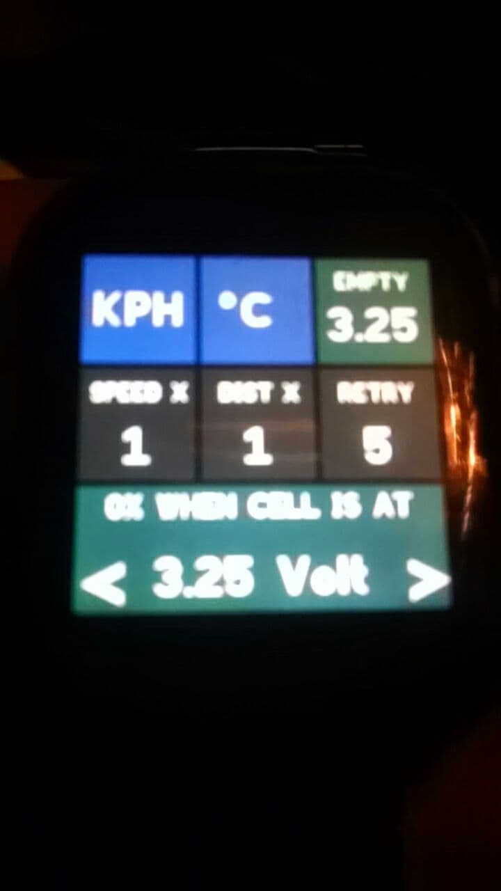

two more features on testing:
the "empty" button sets the battery lowest limit per cell, so that battery percent can be calibrated.
the "retry" button sets how many times the watch will retry connecting when on "lost" before it auto turns it self off.
