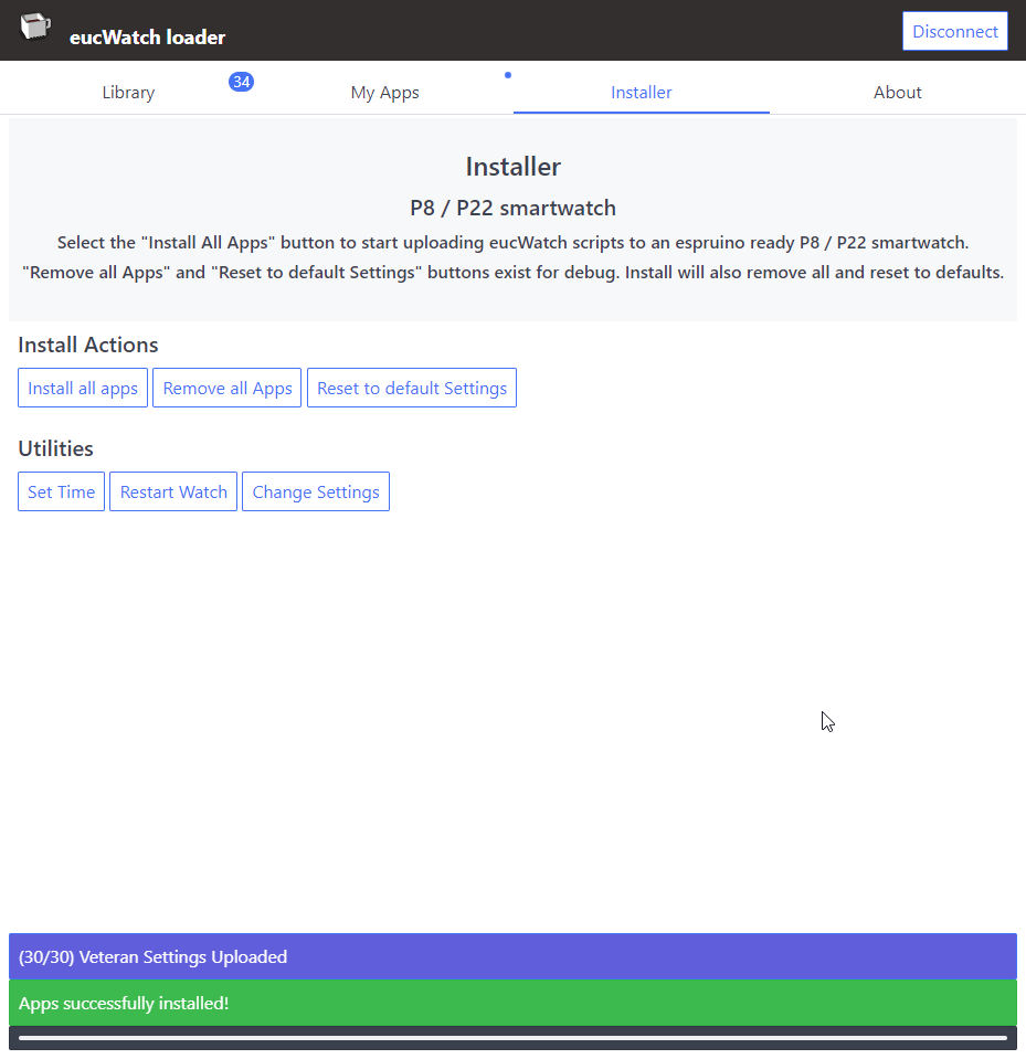

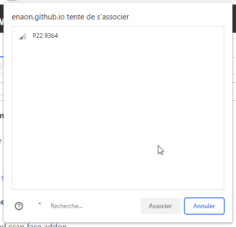

Bon j'ai voulu tester avec ma GT16 et cette appli sur la montre, mais j'ai comme un problème.
J'ai bien respecté les 4 étapes pour flasher et la 4ème étape j'ai choisi le ESPRUINO P22 et quand j'ajoute les applications sur https://enaon.github.io/eucWatch/p8-testing   j'ai ma montre avec un seul carré jaune. (j'ai aussi essayé sur https://enaon.github.io/eucWatch/p8)
Pour information elle se nomme P22 93b4, voir imprim écran
Et quand je charge toutes les application ben j'ai le message qui me dit que c'est ok
Une idée de ou j'ai merdé ?

4 hours ago, inogonzo said:
Any idea where I screwed up?
Not your fault, this is either a p22B1 or a p22D.
Go to the loader(testing only for P22), connect, delete
core - P8-P22 A/B/C/C1 (v0.91)
and install
core - P22 B1/D (v0.94)
and press disconnect, it should reboot to a working screen.
then if it is a B1, you maybe have to change handler file too the same way. it depends on if the touch is working ok or not.
Quote
For information it is called P22 93b4, see print screen
this is just the bluetooth name on espruino, the real model version name is in the about screen on original firmware, but it will be ok, just change core file.

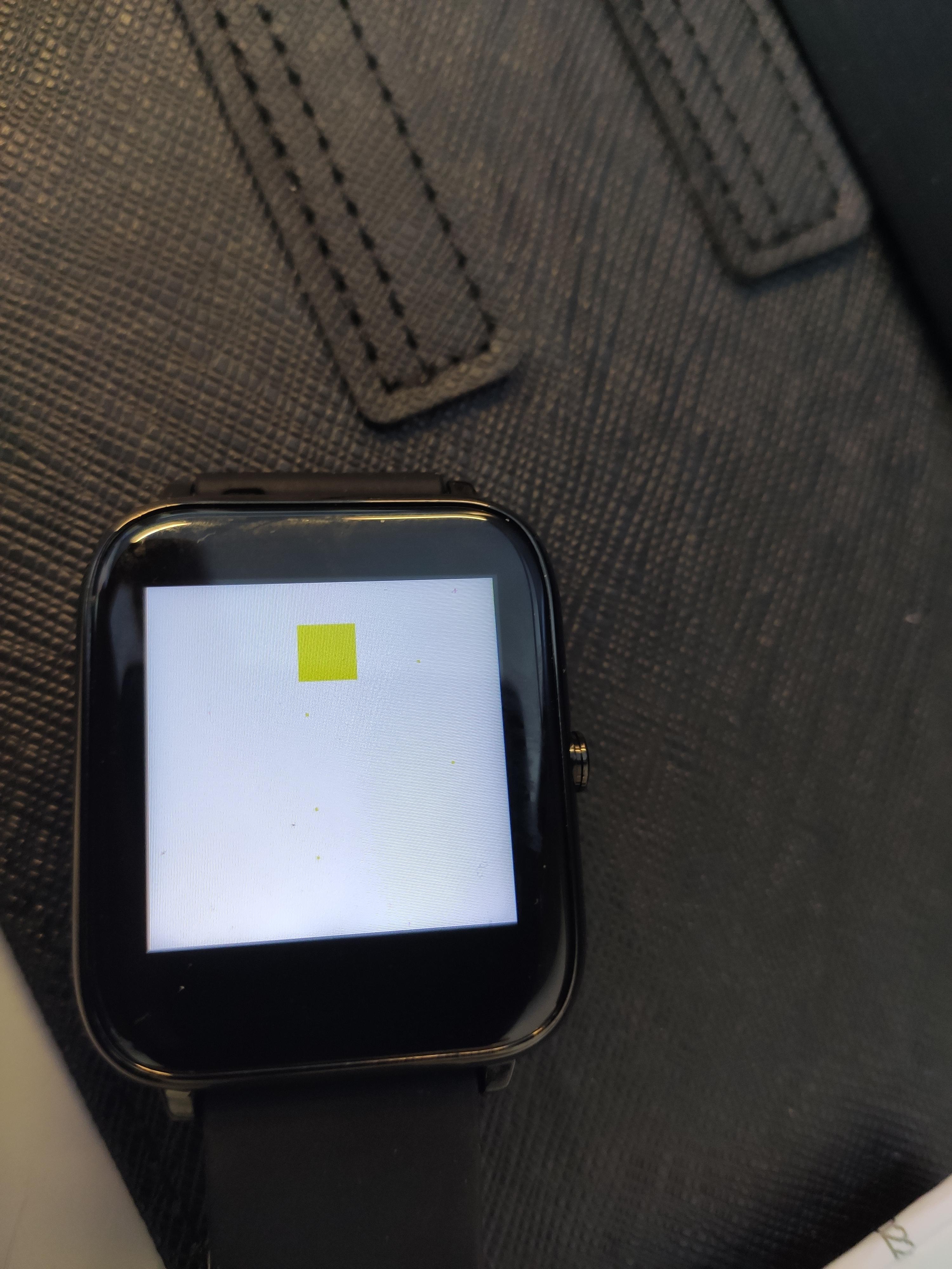

Thanks for the information, the watch is now working!
And it connects well to the GT16 with the kingsong profile and it displays the KM / H well
But there is a problem, connected or not to the GT16, the touchscreen reacts strangely, without touching it, the watch enters the menus on its own, it deactivates / activates certain functions and almost never detects movements.
I couldn't test an outing with it, rain all weekend, but in any case impossible to have the screen on for a long time because it changes mode all the time and the screen turns on and off by itself.
PS: I tried the "Handler - P22 B1" and the "Handler - P8 - P22 A / B / C / C1 / D", the problem is the same.

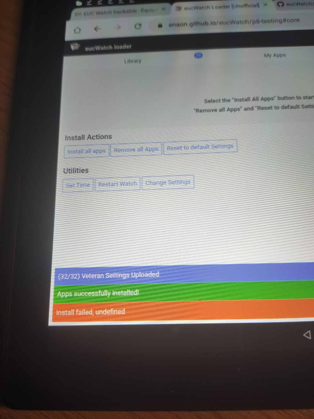

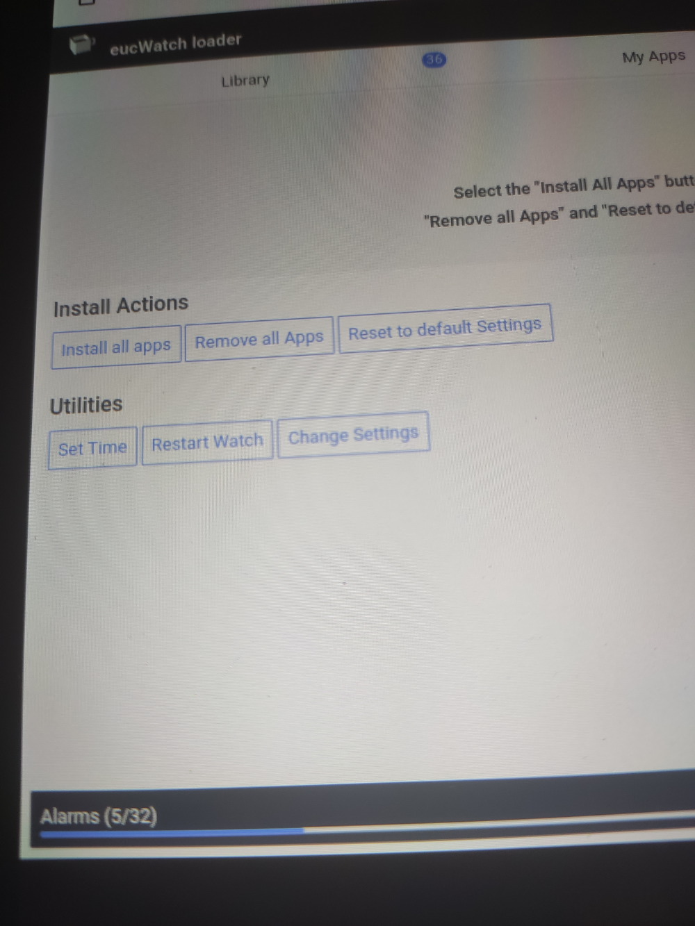

Well I have tried everything, even reflash Step 4 just in case.
For the installation of the apps, I forgot to say that the installation does not always work the first time, I have 2 types of errors:
* the download of applications is blocked at step 5 "alarms"
* all the applications load and I have the message "Apps successfully installed" but just after "Install failed, undefined"
Well after several tries I manage to have only "Apps successfully installed", but nothing helps I still have the touch bug ...
this is a known reporting bug, it doesn't affect performance as you correctly noticed. Thanks for all the tests, I am currently extending V11 and adding V5/8/10, as soon as it is done I will look close to make sure it is not something I missed.
