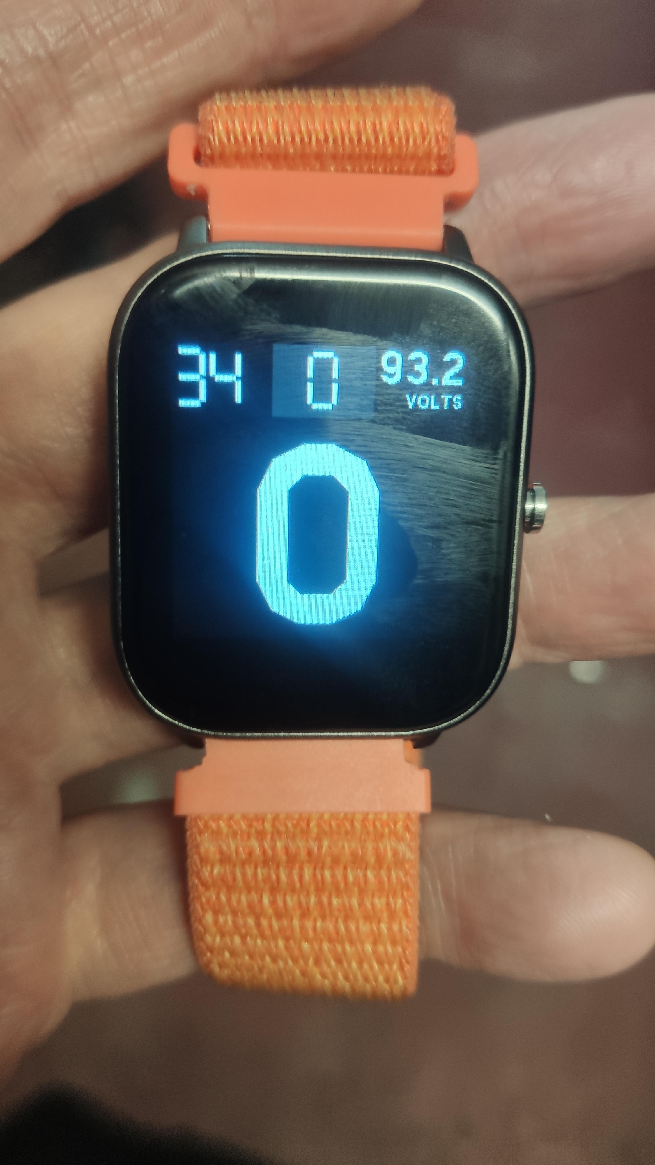

Il y a 10 heures, enaon a dit :
If anyone is using a gotway, I think I have good news.
A friend of mine had an accident on a gw, what else, he could not hear the buzzer.
The wheel came to me for inspection, and I got some motivation to look if the buzzer is reported on the bt level. The wheel is a moster v3, and I found a flag that is raised when the buzzer is on.
Anyone that want to test, do the three updates using the site:
https://enaon.github.io/eucWatch/p8#
the buzzer will cause 4 long haptic feedbacks on the watch, and light up a exclamation mark to the digital dash.
Please test if you have some time.

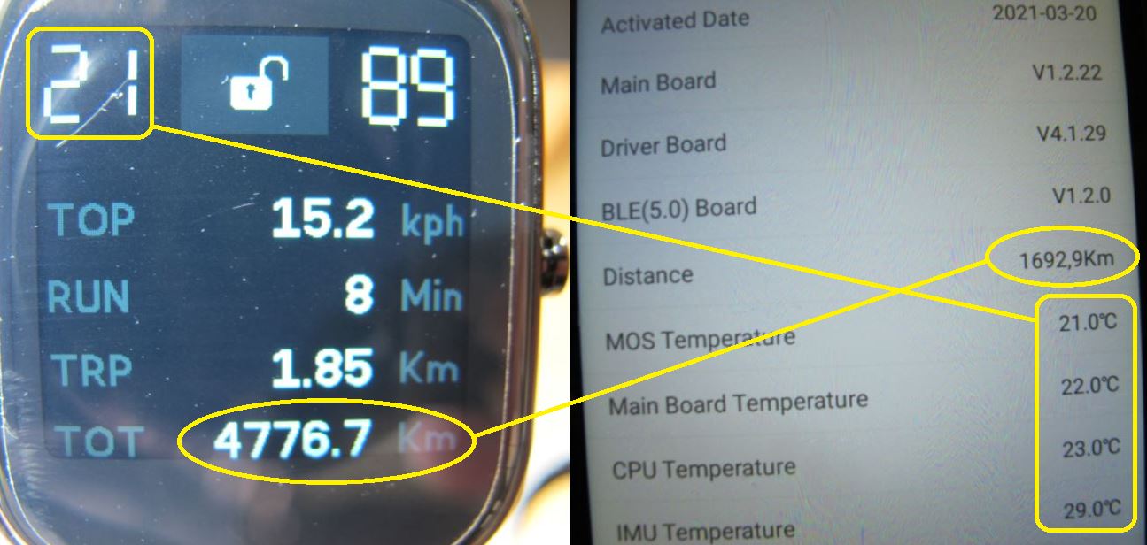

So, I can confirm that there are improvements (trip distance ...) for v11, thank you very much.
Hi @enaon , I did some v11 tests this morning.
First, big problem :
V11 connection OK, then I start my trip by displaying the main menu ... and, after about 1 km, speed and others frozen. I off-on the connection, that re-run for 1 km. After several iterations, the watch shows only the simplified menu (with large speed) ... and the sliding fonction absolutely inactive in all directions. My God...
Fortunately, github accept to connect (unknown device), I test "set time": OK, then I re-download ALL, OK
I test on a KS18A = ok, everything works fine
I test on v11 = it's stable, it works. Well, my test was short, just a few comments.
-- the TRIP length seems correct,
-- the global odometer does not have the correct scale factor:  NO
-- the temperature measurement is good, difficult to know which one it is...
I will do a longer test this afternoon
Edit : I just did a loop in v11, my gps tracker says: 54.99 km and the watch: 58.52 km. Not so bad... Température 27°C. Batterie 42%.
However, I see that TOP is still 15.2 kph, RUN is still 8 Min, TOT is still 4776.7  :D , Yes, work in progress... All these adjustments are not urgent, the current state is nice, it shows that this watch is very useful, really ...

For inmotion, total trip, top speed  and time is not yet gathered, so I guess what you see is the info from the kingsong wheel, or  a mistake. I will fix that and let you know so you can test. For the temperature on the inmotion  I use the mos field, I think it is the most important.

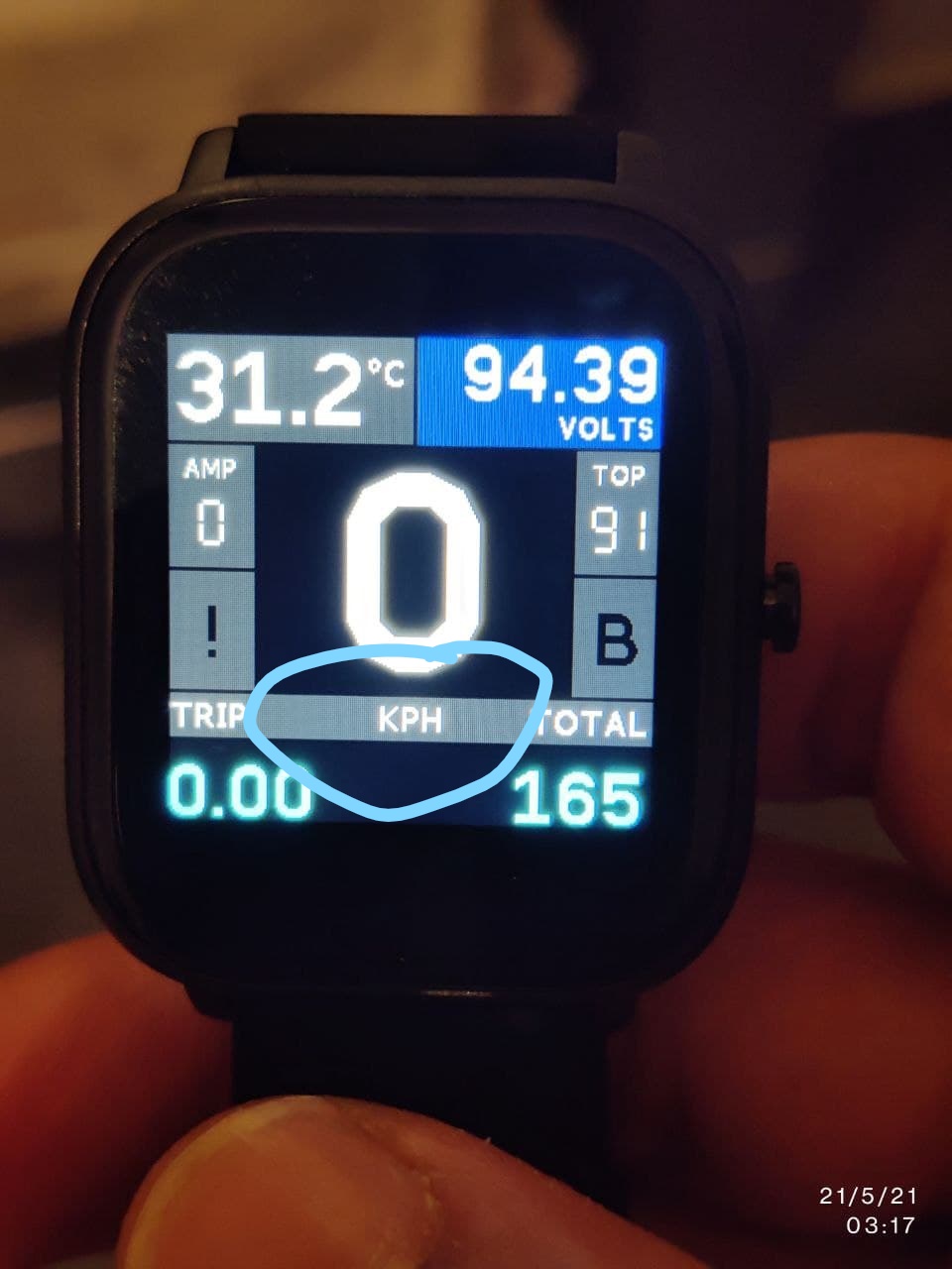

Thanks @enaon , i have disabled speed in Haptic menu , i check this tomotrow or later . For the unit ( miles or kph ) i don't have indication on my panel watch ? I just have volt, temp and speed ,
Thank
Do a swipe down, it will change to the digital dash, you can set the miles/kph there, and it will keep it for the simple dash too. :)
(change to simple dash by swipe down again)
Modifié par enaon
