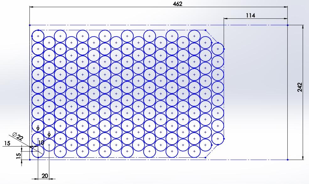

I am willing to buy a model from alibaba.com for around 1500USD including shipping to Romania. I'm not sure about the material used. Is it aluminum 6060 or other series or is it steel? Why does it rust. I am buying the scooter to convert carbon fiber material with replacement parts CNC milled. I know I can buy a chinese 50 + mph that has a battery of 35Ah with 3200W dual motors but I like the design and I wanna change it to be lighter and maybe in the future I can replace the 8inch 1200W with 1600W motors and have a 50Ah 21700 cell type battery (16S10P) inside to reach up to 250km range.Also I'm asking, is there someone that sells the MX60 at a lower price than 1500USD with shipping included to Romania?. Waiting for answer or opinions.

Do you plan to use Samsung INR21700-50E as 21700 batteries ? Did you already tried them ? I'm looking to use them for a DIY external battery as well.
Not sure for 250km range with 50Ah, I would say more around 150km when used around 50km/h with dual motors on flat roads. (And even less at full speed, 100km around 65km/h with hills).

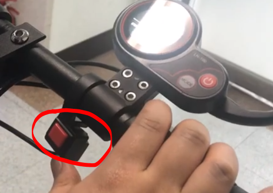

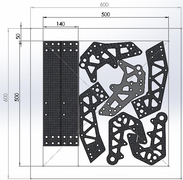

I have estimated that motors would be: 12kg, 7kg battery, and around 10kg the chassis and components. I have calculated a rought weigth of 3kg for the frame made from carbon fiber or E glass fiber. Yes the Samsung INR21700-50E but for the first concept I will be using the Panasonic 18650 3.5Ah cells. I want to at least pass the 100km range. Does the scooter have 1 motor to 2 motor switch button?. I didn't see any spec. By using one motor the range on flat surfaces would be greater.
I really don't care that this scooter does not reach 100Km/h like others because I want to be light and have range. Don't wanna charge it every couple of days. Who has the scooter?. I want to have some pictures of it that i'm interested also about the thickness of the plates. PS me.

Yes, I think you can easily acheive 100Km range depending of the speed and number of motors used (when you multiply the speed by a factor of 3, you can easily divide the range by 2).
According to a video posted before, there is a button (but not sure what for ?!) :

It seems to be really interesting your proyect. Would you redo all existing cnc parts in carbon fiber? How will you do it?

Hi, @SMC , are you sure that the removable enclosure contains a 16S10P configuration? If so, it's a good idea to replace the cells on the main pack... and make another 35 Ah battery carried on the luggage rack, and take it only if you have a very long trip, the exchange is wonderfully easy ... :)

Hello. The removable enclosure has indeed 16S10P configuration just it has 2Ah chineese cells. I was also analizing the idea of changing the 160 cells with 21700 type cells in order to have a 70Ah battery split into two 35Ah (80 cells ) in the same space as the original battery with custom 3D plastic holders and integrated cooling. By doing this I can make a DIY mod to remove some of the steel shield in order to get half of the battery out when it is out of juice and have it recharged when sitting still with fast charging charger placed on the rack and the other way around for the other half..
