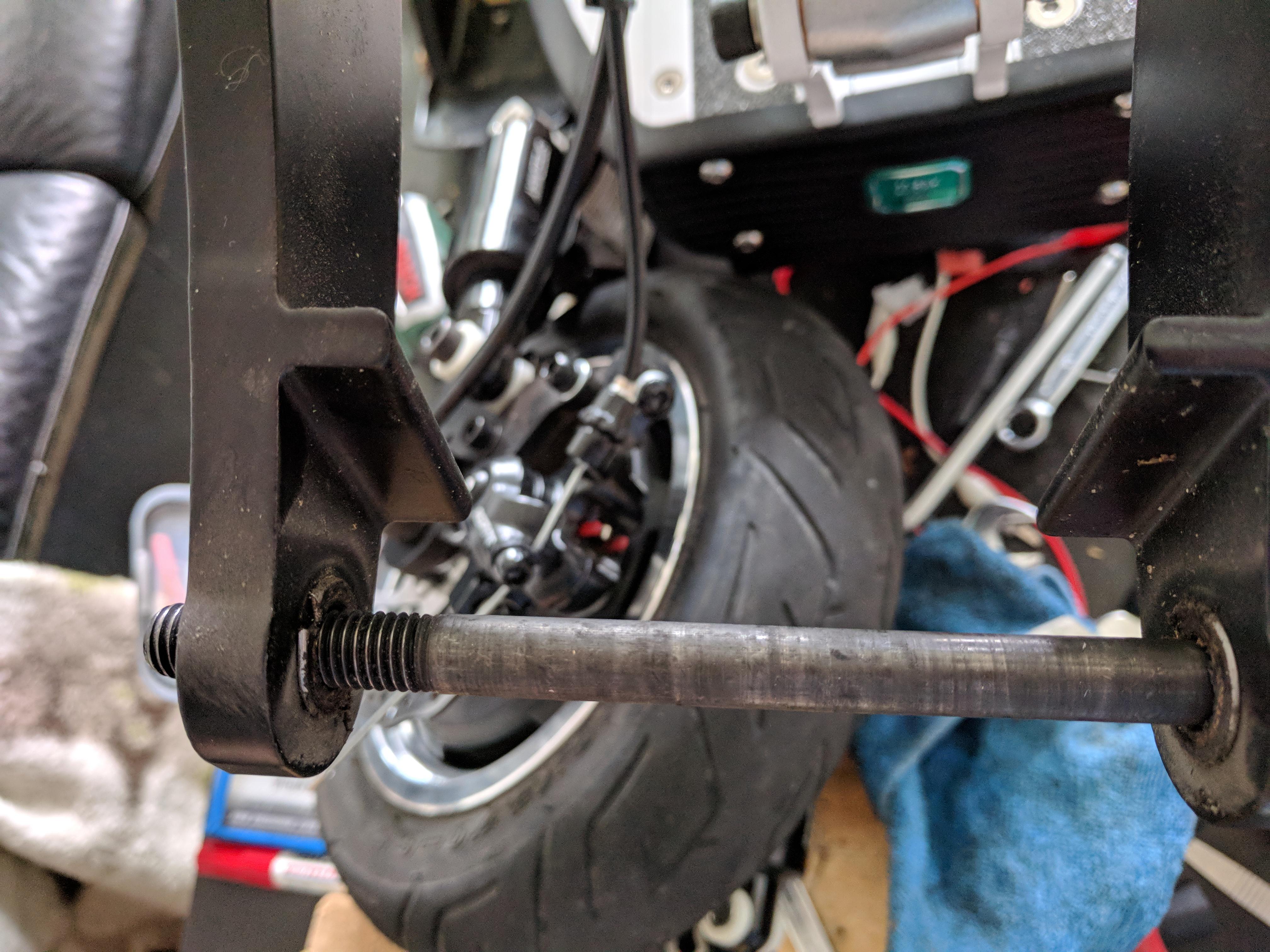

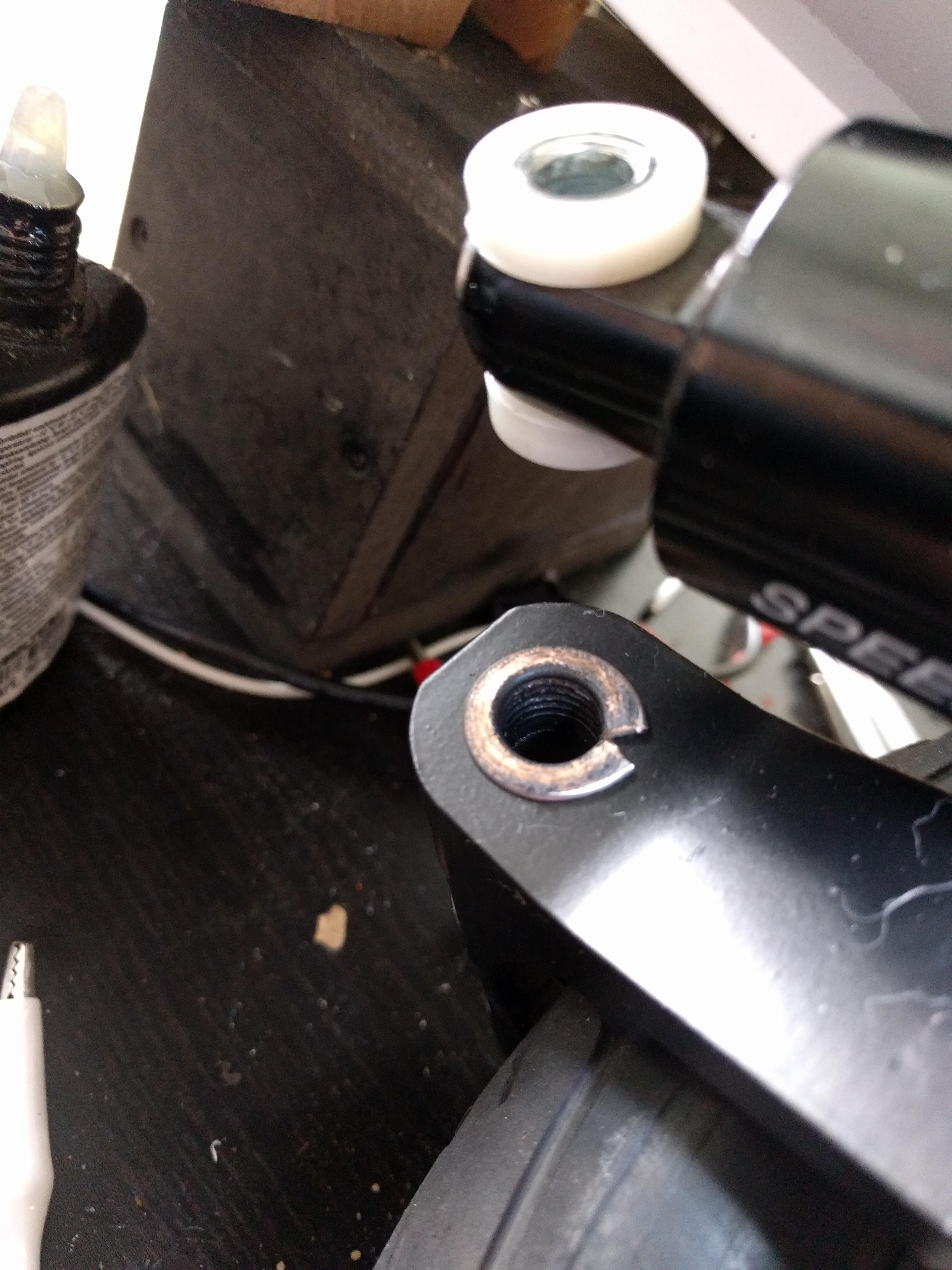

I realise this is a french discussion, but it seems there's a problem with the bolt size for front and rear axle, leading to busted bushings.
They used an M10x150 12.9 , but the shoulder needs to be longer, so I'm replacing them with M10x180 12.9 + spacer. And then using an angle grinder to remove the excess thread.
https://www.ebay.com/itm/301718638145 You really only need two, but I purchased these.
And some new bushings https://www.aliexpress.com/item/32831294510.html SF-1F10120 so you want to select option 10120
Attached some images of the front fork.
This FAQ has been a nice resource, I hope someone can translate and add this to the top post. :)
Modifié par drebsdorf
Replaced Dropbox links with files, +bushing size
