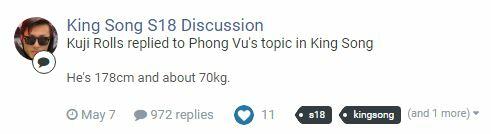

Il est léger plutôt Kuji et il est certainement très près de la limite de la roue de se pencher autant.
S'il pesait 85 kg...

Kuji est grand et longiligne, il reste très droit lors de ses accélérations, d'où son style très impressionnant.
On ne peut pas dire qu'il est léger, même s'il à une bonne marge pour devenir gras du bide comme nous :

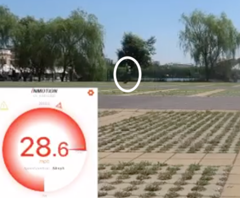

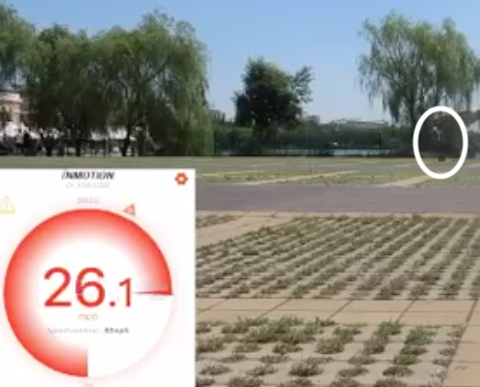

Début du redressement de Kuji (9 s:
Fin de l'accélération (10 s; au temps de retard d'affichage près...) :
Le tilt back de la V11 a dû intervenir entre ces 2 images...

"Just to clarify for casual readers:
  • Kuji did not test for max speed. He stated that he has a firmware capable 55 km/h. That was an acceleration test.
  • That was a pretty nice acceleration for an 18x3 wheel!! :clap3:
  • the alarm heard was for overpower, which is triggered when power demand is more than the trigger point (unknown at the moment) for extended periods, likely a second or two.
  • The clue is on the app display. You can see the power meter go red for most of the run and power reading going up to 3500W and being over 3000W for almost a second. The wheel can do more for peak power, it’s not at the limits. But they’re not allowing the wheel to exceed its nominal 3000W (control board) for extended periods to protect from overheating.
  • The firmware is still under development so it’s possible the threshold is not yet set and we can also ask for different behavior. They are listening pretty well now. But the idea of getting off is to let it cool down a bit. I agree it can be annoying. It would probably cool down with slow riding also.
  • We don’t actually know what happened as the video was cut too early.
  • This should happen much less on a V11 with 12 beefy MOSFETs vs 6 on the V10.
  • If you keep demanding more than the nominal power for long periods you should consider another wheel or changing the way you ride. Especially at 120 kg. Acceleration is the most demanding task for the wheel. If you truly understand how these machines work you would not lean like Kuji in traffic. Especially at 120 kg on a V10. Or on any wheel. Just because they don’t have the same trigger for alarm doesn’t mean they are not using the same power. We enjoy acceleration understandably on every possible thing we ride but EUCs are special by nature and should be respected.
  • In general, I think the Inmotion approach is a good one as long as the limits are wide enough and not too conservative. Better to protect the wheel and rider. I’d rather step off the wheel sooner for a while than step off later to replace the fuse or wires."

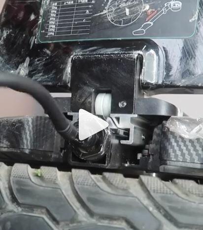

Mmmhh, je ne suis pas enthousiasmé par la glissière, à patins, galets ou billes (?), elle est très exposée aux salissures.
Il faudra peut-être développer un soufflet-tétine en flex sur imprimante 3D...
Ou carrément un carter rigide qui coiffe l'ensemble...
J'ai vu et je m'en doutais plus ou moins : dès la première vidéo de la V11 je m'étais dit que si un gravillon ou du sable rentrait dans la partie coulissante ça allait être coton.
Et en fait la photo me rassure plutôt. Il y a suffisamment d'espace entre la glissière et la rainure de guidage pour craindre davantage les gravillons que le sable. Vu la quantité de frottements et de mouvements je pense qu'un soufflet au bout de la rainure de guidage aurait une faible durée de vie.
Non moi ce que je vois c'est une solution simple que l'on utilisait souvent à 20 ans dans un tout autre domaine : quand on ne veut pas que ça frotte on lubrifie. Donc je pense que je vais généreusement enduire cette glissière de graisse pour faciliter un mariage harmonieux 😉
Modifié par Ibaloo
Il y a 5 heures, Ibaloo a dit :
J'ai peur que sa lubrification/graissage ne fasse qu'empirer le problème : le sable et la poussière,  très propice à cet endroit, vont venir s'y coller.
Je ne pense pas que ça va être aussi gênant. Le sable et la poussière je m'en fiche. Au pire si je trouve ça problématique je mets un coup de savon noir et je re-graisse 🙂
Ce que je ne veux pas c'est qu'un gravillon se coince entre le rail et la glissière. Et pour ça la graisse sera très bien.
